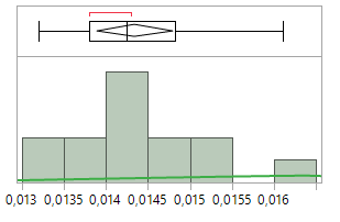

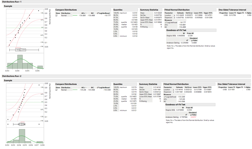

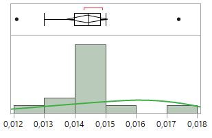

Using JMP 15, the Analyze->Distribution density curve is not fitting properly. A few examples below. The parameters for the fitted normal seems correct, but the density curve is off. Works fine for "life distribution" density curve or when i multiply the data by eg. 1000. What's going on here?
Fitted Normal Distribution
Parameter
Estimate
Std Error
Lower 95%
Upper 95%
Location
μ
0,0143429
0,0002075
0,0139362
0,0147495
Dispersion
σ
0,0007763
0,0055724
6,025e-10
0,0008905
Parameter
Estimate
Std Error
Lower 95%
Upper 95%
Location
μ
0,0144143
0,0003122
0,0138024
0,0150261
Dispersion
σ
0,0011681
0,0068354
1,22e-8
0,0013398
