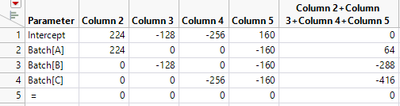

@thayermo07 , here is how ya do it via Custom Test (I have batch where you will have dose).
First, do a custom test to find the coefficients you need in the Custom Test dialog.  You say you need this contrast:  224, -128, -256, 160.
Ok, so put those in four columns in the custom test like this. Batch D is that way because of the way the model (via Fit Model platform) is parameterized.
Then add across columns to get the following.
Then, finally, do another custom test to get your final contrast of interest. i.e., the contrast shown below is your desired quadratic contrast. It is important to understand how the model (via the Fit Model platform) is parameterized to use the Custom Test dialog correctly.

This is a bit confusing to me. Would you mind sharing a link to material explaining this? Just at first glance, why is column 5 160 and then negative 160 for the cells below it?
