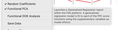

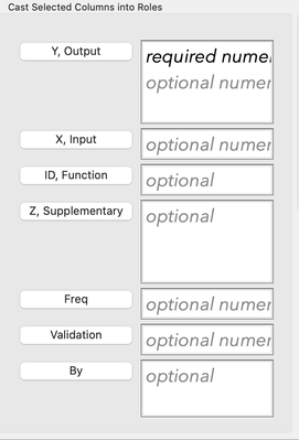

this might be relatively easy to do.  When you launch the Functional Data Explorer, add your chemical composition columns into the supplementary variables role in the launch dialog.  After cleanup and fitting, click on the Functional DOE Analysis option.  (you must have supplementary variables for this to work)
