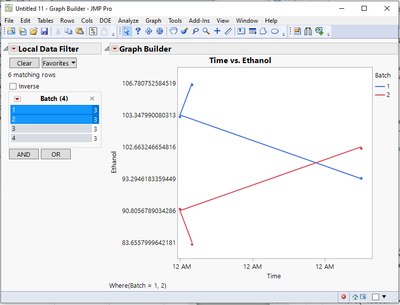

Here is an example that produces your Ethanol chart, with fictitious data
Here is a script that produces the plot

Jim

Jim

I actually used to work in this industry and have fond memories of all the different data formats we ran into... Most commonly it was the horizontal data format that you provided. Jim is exactly right that you need to do some combination of stacking and splitting the table. I would make one very small suggestion to the above script. If you use the format "hr:m" in the below line it will result in the duration units instead of time of day.
Have fun!
// Create new time and Type of Gas
dtStack << New Column( "Time", Format( "hr:m" ), set each value( Num( Word( 1, :label, "hr" ) ) * 3600 ) );
