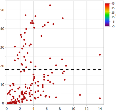

Hi there - the graph that a colleague of mine made originally had markers color coded by a continuous column (see "Original" image). When they save the script and re-run the script to re-create the graph, the color-coding goes away and all of the markers become maroon (see "After" image). Do you have any suggestions for how to keep the color-coding such that each time the graph script is run, the color coding stays? What could be the issue?
Original
-->After rerunning the script and despite saving the color scheme:
After

Hi
我使用的是Big Class.jmp。用‘身高’和‘体重’作为Y和X。把‘身高’放入‘颜色’。
选择需要的色阶,然后将label中点的配置进行调整。(如图)
然后保存脚本就可以了。脚本中主要的区别是图中的点被定义的次数不同。
调整后的脚本如下:

未做调整的脚本如下:
多了scatter plot开始时默认时的定义
Properties( 1, {Line Color( -11538191 ), Fill Color( -11538191 ), gradient( {Color Theme( "Spectral" )} )}, Item ID( "height", 2 ))
