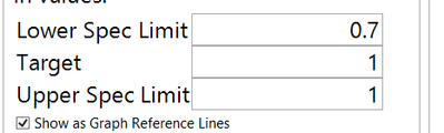

I have added the specs for all my resposnses. They are all within spec, but when I do a process capability my capability index plot is  all under 1 (Ppk value).
I do not understand why. Even the Ccp are below 1. Do I need to increase the specs range. Can someone help me?

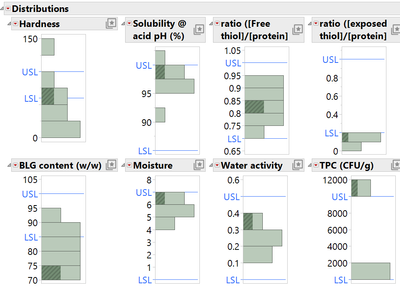

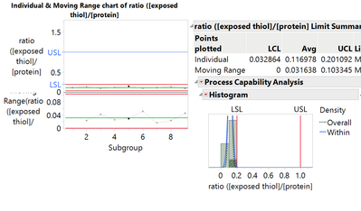

It's hard to comment with just those images, can you provide the dataset? I can see from the images that your spread/variability is quite large on some of your process variables, and a lot of them have a mean shifted away.

It isn't a good idea to have a target meeting the USL or LSL level exactly, ideally the target sits between the two. Your settings are far away from where you have set your spec limits. The real question to ask now is - are your spec limits appropriate for your conditions? How have you decided your spec limits? Is it something strictly set as a critical quality marker that your results have to fall within - if so then you may want to investigate why your responses aren't achieving those targets.
I think you had best review your process and get a better understanding of applying the SPC, there are some good resources here and here. I would also suggest looking at some of the other platforms in JMP like the distribution platform to show a quick overview of what your responses are vs. the limits you are setting.

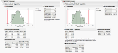

the reason you are getting a low Ppk even when not having any out of spec points is because Ppk is based upon the fitted distribution of your data and not the raw data itself:
So here you can see that due to the variation in your data and the low sample sizes the tails of the fitted distribution are much larger than the raw data and cross over your spec limits.  What the fitted distribution is saying is that if you were to collect a lot more samples, you eventually would start to have out of spec values.  This is why fitting a correct distribution to your data is so critical for Process Capability.
