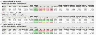

May I know where is wrong in the scrip I would like to generate the process capability report by lot_id as below.
