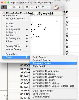

Have you included automatic recalculation in the figure?
Bivariate( Y( :height ), X( :weight ), Automatic Recalc( 1 ) )

Yep, it's turned on. The plot updates prior to opening the filter and after closing the filter, a little bit later. Just can't figure out why it doesn't work with the filter on. I can try switching back to using 'Current Data Table()' in lieu of DataTable12 but I do acknowledge that it causes other problems if that value changes.
