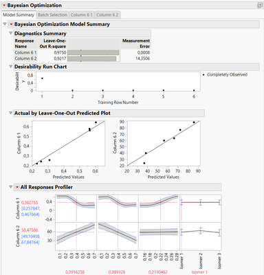

Looking at your last file, when launching the BayesOpt platform from scratch only using the 6 initial space-filling runs, the models seem already quite good :

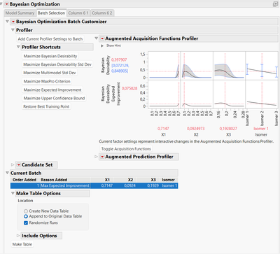

When relaunching the platform with this newly added run, the profiler seems to be more reliable, and the default run recommendation is done automatically with the acquisition function "Max Expected Improvement", with settings close to your optimum :

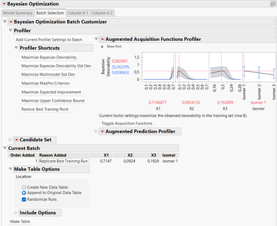

Once this automatically recommended run is added, the next option recommended by the platform is to replicate this best training run:

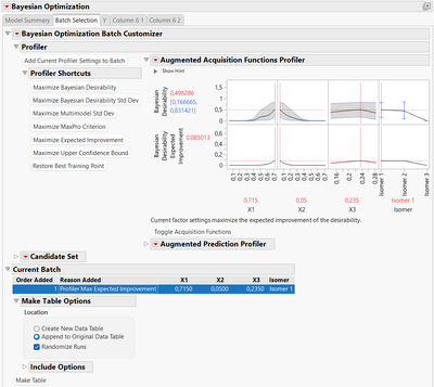

When considering Y and the two other Column 6 responses, you may need one extra Max Multimodel Std Dev run (so two in total, one after the other), before the Profiler shows good ordering and behavior of the different isomer types:
Once you have added 2 runs Max Multimodel Std Dev, you can start the optimization by enforcing the Max Expected Improvement criterion. You should get a solution close to the one obtained with your previous successful attemps (see file Successful 6 Run Fast Flexible Filling Design starter 2).
