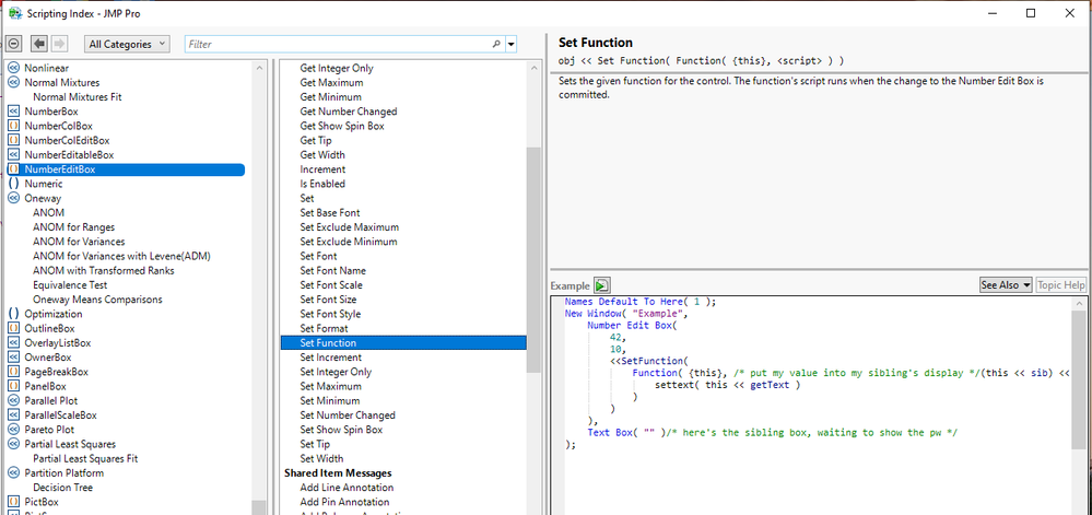

New to jmp and trying to understand how this sequence works - could someone explain how this aspect of the code works? Looks like it saves the box input to a local variable without needing to output text box results to an array, but unsure how the function works to accomplish this.
<<SetFunction(
				Function( {that},
					lowlim = str1 << get
txnelson
Re: Problem With User Input as Variable
One needs to look at more of the code than what you specified, in order to interpret it
deflowlim = Today() - In Days( 730 );
str1 = Number Edit Box(
	deflowlim,
	10,
	<<SetFunction(
		Function( {that},

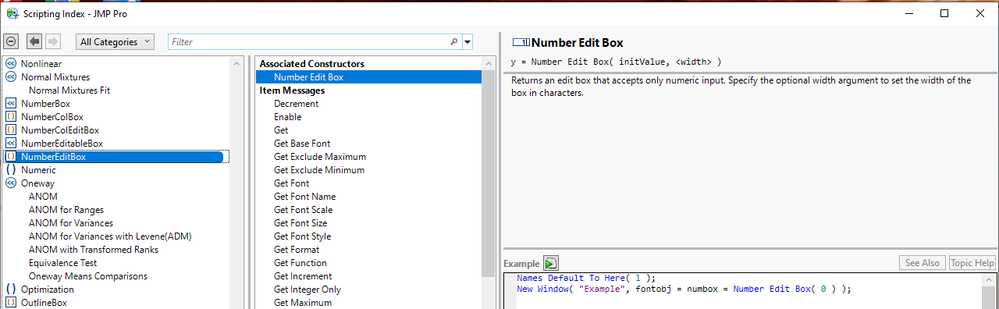

What is basically going on here, is setting up a data entry field to allow the user to enter a date.  The type of data entry field is a Number Edit Box(). (See documentation and example of Number Edit Box() in the Scripting Index under the Help pull down menu).
The documentation states that form of the Number Edit Box() is:
y = Number Edit Box( initValue, <width> )
A variable called "str1" is assigned as a pointer to the Number Edit Box(). In the illustration, this is the "y" variable
The variable, "deflowlim" is used to set the initial value to be displayed in the Number Edit Box(). In the illustration, this is the "initValue".
The width of the Number Edit Box() is set to 10 characters

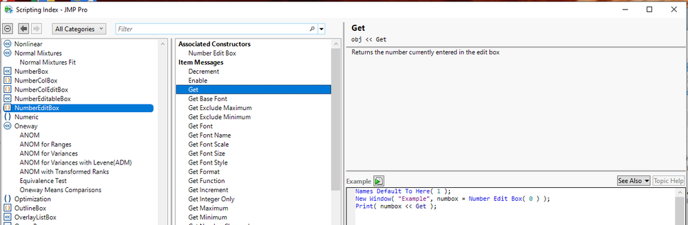

As can be seen in the above documentation listing, there are a large number of Item Messages that can be passed to the Number Edit Box() object.  The message in question from the code you are asking about, is "Set Function".  Here is the listing from the Scripting Index
What this message does, is to set up a piece of JSL that is run whenever something is changed in the Number Edit Box().
So every time, something is changed in the Number Edit Box(), a "get" message is passed to "str1", which is the Number Edit Box()
The "get" message is:
Returns the number currently entered in the edit box
and the returned number is assigned to the variable "lowlim".
Therefore, "lowlim" is a scalar variable, which can be referenced in subsequent JSL.  Only a scalar variable needs to be assigned, since JMP dates are stored as a continuous numeric data value.
I hope this clears up your question(s).
Jim
