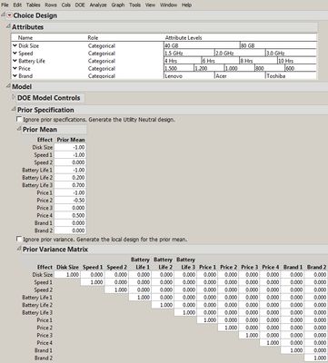

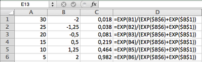

first of all many thanks for helping such a newbie to statistics as I am! I wanted to to double check with you if I understood the probability function correct. I calculated the probabilities from the example as following. Is this correct?
You write "Typically the fitted coefficients of choice experiments are less than 2 in magnitude." Thats most likely the reason why John Sall uses in his example Optimal Design of the Choice Experiment - JMP Blog a magnitude from 1- till 1. Right?
Final question. Based on the example from John Sall I created an slightly extended choice design. Only the attribute brand has no known preferred direction for an level. But the prior variance matrix for brand 1 and brand 2 is still 1.000. Is this correct and do you see any heavy issues in my first choice design?
Many thanks in advance,
Herbert

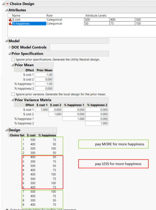

I thought that I understood prior mean based on the above and some other posts/videos, but I am not understanding why the choice design, attached, is being generated. The attributes cost and happiness are listed in increasing order of value, and the prior mean is set as shown in the computer example above. This should prevent choice sets being displayed that offer the best of both. However, as shown, sets 1,2,7,8 are correct (more happiness costs more), but the others give the option of selecting more happiness for a lower cost.
Besides the issue of happiness should not have a cost, what am I missing here? All of the choice sets should make you choose whether you want to pay more for happiness.
Thanks in advance.
