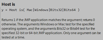

Also, from the scripting index:
and...
JMP Product Name();
"Pro" (or "Standard")
and...
Build Information();
"Feb  9 2015, 06:42:57, Release, JMP Pro"
Build Information is mostly for our internal use and the format has changed over time.  You should use the JMP Product Name() if it does what you need.
