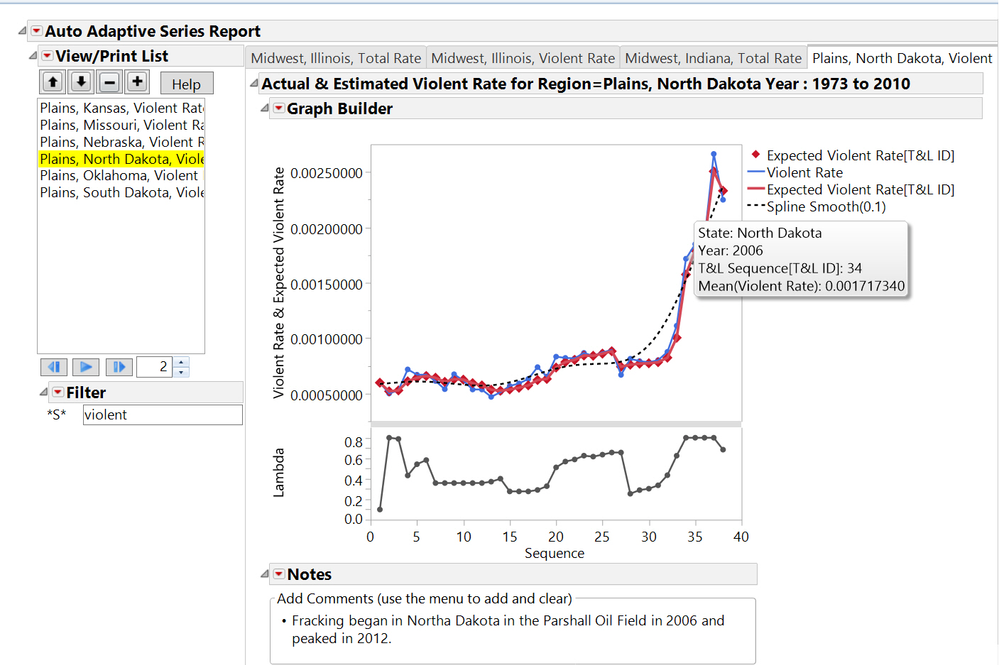

Have you considered using a tabbed report with a selector?  See the picture below.  Or are you creating a page with multiple graphs, for example, side-by-side, for each view.
Also,  other alternatives are:
  1. Create your Bivariate with two splines with collapsed (hidden) boxes. Until the user selects a value or the button, set the 2nd spline's line width to 0 so it would not be visible. Allow the user to select what the second spline's value should be. In other words, you are not adding a ton of splines, just send a message to change the smoothing factor of one. That would eliminate any jumping.
  2. Change the behavior of your Add Spline button to add a curve using Add Graphics Script, instead of using the UI messgae Fit Spline.  This would take extra scripting: using functions to get coefficients, evaluate, chose a color, add the graphics script,
Option #1 would be the easiest
The JMP UI slider anticipates what you are trying to emulate, the user can adjust the smoothing factor.
