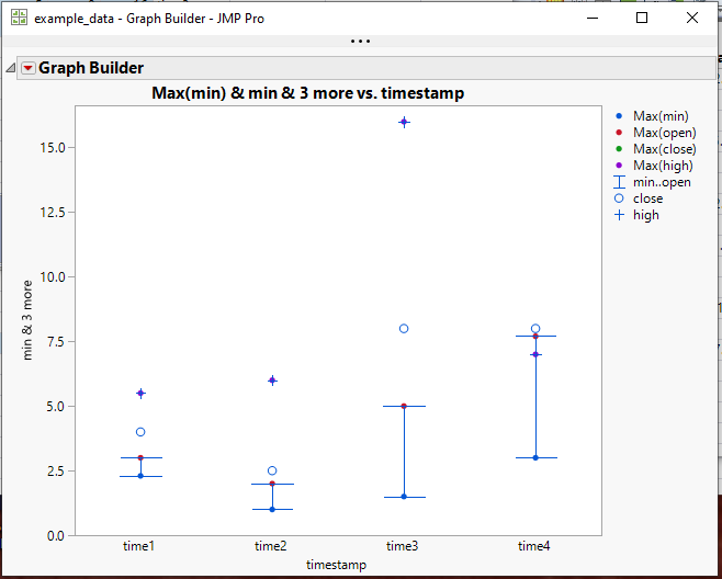

Hello Everybody,
the data describing stock price movements is created by open/close price and max/min price. Is there any way to create box plot (candlestick chart) in JMP having real body from open and close price and upper and lower shadow having values in max (high) and min (low) prices respectively, like in the picture attached or is there better way to do that? The traditional Box Plot element, however, shows outlier or quantile box plots and provides a compact view of a distribution of values. I attached an example data table in which several timestamps and price values (min, open, close and high) are provided. I would appreciate for hints and suggestions.

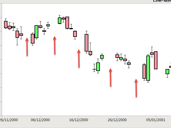

I had a little more time to look into this, and I think the easy solution below might be a workable solution for you.
Names Default To Here( 1 );
dt = Open( "$SAMPLE_DATA/Stock Prices.jmp" );
dt:open << label;
dt:close << label;
gb = dt << Graph Builder(
	Size( 1289, 456 ),
	Show Control Panel( 0 ),
	Variables( X( :Date ), Y( :High ), Y( :Low, Position( 1 ) ) ),
	Elements( Bar( X, Y( 1 ), Y( 2 ), Legend( 10 ), Bar Style( "Interval" ) ) ),
	SendToReport(
		Dispatch(
			"Date",
			ScaleBox,
			{ Interval( "Day" ), Inc( 1 ),
			Minor Ticks( 0 )}
		Dispatch(
			"400",
			ScaleBox,
			{Legend Model(
				10,
				Properties( 0, {Line Width( 2 )}, Item ID( "High..Low", 1 ) )
// Add the boxes to the chart
Report( gb )[framebox( 1 )] << add graphics script(
	halfDayincr = In Days( 1 ) / 2 * .8;
	days = (Col Max( :Date ) - Col Min( :Date )) / In Days( 1 );
	Pen Color( black );
	Pen Size( 2 );
	For( i = 1, i <= N Rows( dt ), i++,
		If( :Open[i] <= :close[i],
			Fill Color( light green );
			Fill Color( light red );
		Rect( :date[i] - halfDayincr, Max( :open[i], :close[i] ), :date[i] + halfDayincr, Min( :open[i], :close[i] ), 1 );
		Rect( :date[i] - halfDayincr, Max( :open[i], :close[i] ), :date[i] + halfDayincr, Min( :open[i], :close[i] ), 0 );

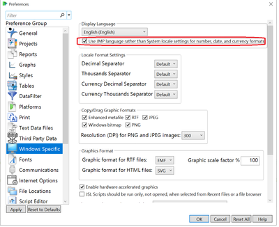

Hi @lukasz
with respect to decimal points using "." or "," perhaps you can fix this from the preferences as in the picture below. Yet, i would assume that all other data sets that you are using will change for the wrong...
In this case, in order to just amend the format of a specific column in one file you can use the following command:
Format( x, "Currency", 20, <<Use Locale(0) );
Full description in this link:
https://www.jmp.com/support/help/zh-cn/15.2/index.shtml#page/jmp/formatting-numbers.shtml
let us know if it works.

  • How can remove the gaps in the graph that are not trading days?
  • Thank Jim!
jthi
Re: Presenting stock data in form of box plot
You will most likely have to change X-axis to nominal and then possibly modify the graphics script to accommodate for that change.
