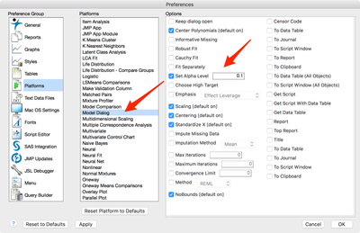

Hi all,
Anyone know of an easy way to set a preference that changes the alpha value for multiple comparisons tests in Fit Model? I was thinking I would find it in Preferences > Platforms > LSMeans Comparisons but it isn't there.
Right now all I can do is either (1) CTRL-SHIFT-click the LSMeans option that I want and type the new alpha in multiple times, or (2) build the analysis with the default 0.05, save the script, and search and replace the 0.05 out of the script with the new alpha.
(More generally, is there a single list of all alpha-related preferences throughout JMP? I'd find a blanket change of alpha useful when I'm working on projects that need a stricter value for alpha.)
Thanks

I think the Set Alpha Level preference in the Model Dialog section will get you what you're looking for.

Perfect. I didn't think about Model Dialog. I thought I had to be in the actual "subplatform" I was using (in this case the LSMeans Comparisons). Good to remember to think both general and specific when looking for a preference.
Can we get a "search for preference" option in the preferences dialog someday? Maybe in JMP 15 or 16?
