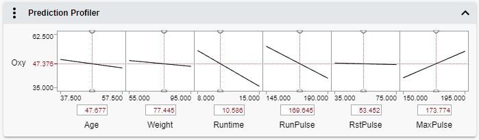

Re: Prediction profiler not working in interactive HTML file
It works for me:
What version of JMP are you using?

@Mark_Bailey I am using JMP 15. To save HTML file is followed these steps: File> Save As> Interactive HTML with data (save as type)
That is the version of JMP that I used. Those are the actions that I used.
