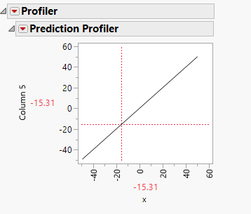

I can't get the prediction profiler to display predictions if my formula contains a Row() statement.
MWE:
the Formula for Column5:
:x
works fine:
while the formula for Column4:
:x[Row()]
results in the prediction not being computed:
Obviously I wouldn't need the Row() statement in the above MWE, but I've run into this problem while trying to build something somewhat more involved. I'm using JMP 16.12.0
Cheers,
Lukas

I'm using the Row() function in the formula for a formula column, not in a standalone script. Shouldn't Row() return a value for each cell in this case?
The formula column I'm trying to profile calculates the cumulative sum / numeric integral of column x up to that row. I've both tried the built-in Col Cumulative Sum function and explicitly programmed the iterative solution int_i = int_{i-1} + x_i , but neither work with the profiler.

Exactly, except it's Lag(:integral)   (i.e. the column itself), not Lag (:x)
