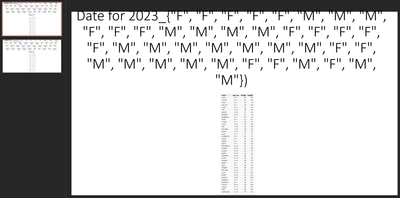

Hi all,
I am trying to create a graph using a subset data. And I needed the column value to be concatenated into the slide's title. For example, the title of the slide is "Data for 2023_" and I need to add what specific sex the data is for. Output should be "Data for 2023_Male" and "Data for 2023_Female". Here is the code I have created
For( v=1, v <= N items (dt_sub), v++,
hb1 = HlistBox();
sex_key= Column(dt_sub[v], "Sex") << get values;
hb1 << Append(Eval(Parse(EvalInsert("dt_graphs^v^"))));
hb1a = hb1 << get picture;
ppt1 = OutlineBox("Date for 2023_" || char(sex_key) || ")", hb1a);
ppt1 << savepresentation( pathppt, append, PNG );
But the output title of the box is Data for 2023_=Scriptable[]
Please help

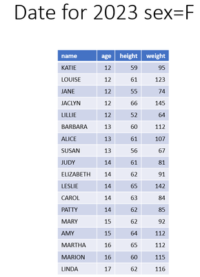

or something like this?
dt_sub = Data Table( "Big Class" ) << Subset(By( :sex ));
pathppt = "C:\temp\ppt.pptx";
//v= 1;
hb1 = HlistBox();
sex_key= dt_sub[v]<<  get name;
hb1 << Append(dt_sub[v] << get as report);
ppt1 = OutlineBox("Date for 2023 " || sex_key, hb1);
ppt1 << savepresentation( pathppt, append, "PNG" );
