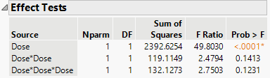

Please realize that linear regression methods have superseded this analysis. In my example, the Dose is a continuous factor but treated as a categorical one to answer your question. I can use regression with a linear model that includes higher-order terms to test the same things.
Here is the result from using contrasts:
Here is the result using linear regression:
The conclusions are the same from both methods (the linear effect is significant, but the quadratic and cubic effects are not significant). Note that the actual tests are different, so the p-values are not the same, but the conclusions are the same.

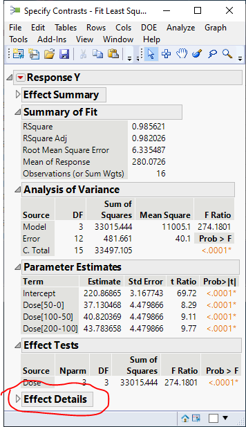

Thank you, Mark, but I could not find the "Open the Effect Details outline." step. I also check "Specify Contrasts.jmp".
(view in My Videos)
Re: Polynomial contrasts in JMP 14 pro
The Effect Details outline is initially at the bottom of the Fit Least Squares window.

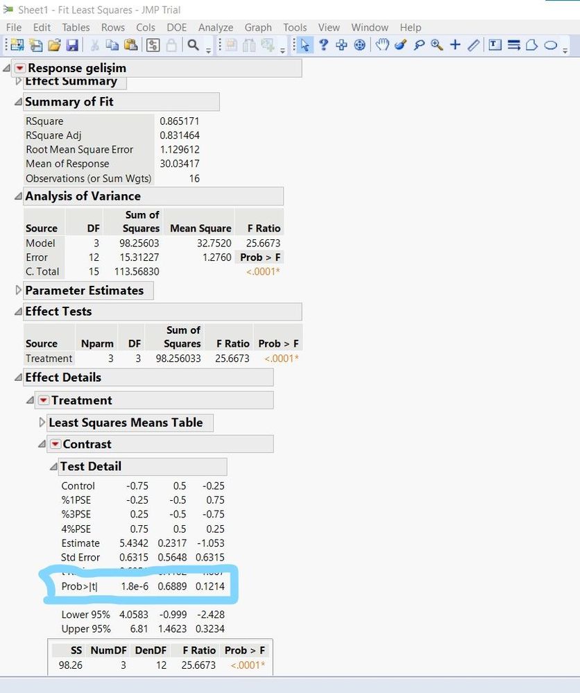

“Model Specification” I need to select “Minimal Report” from the Emphasis menu to get a result similar to yours.
Last question, looking at the “Test Detail” in my attached screenshot, could you please tell me which effect (linear, quadratic, or cubic) is significant or best fit?
I used Minimal Report to minimize the irrelevant information. The choice for Emphasis makes a big difference in the initial report that opens.
I cannot tell you which contrasts are significant, but I can tell you where to find the information you can use to decide. I called out the p-values for each of the individual contrasts so you can find it and decide.
