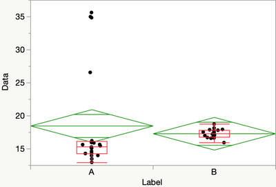

The starting graph is very simple
The objective is to exclude the high points in group A and refit.
I select the points and exclude, but DO NOT HIDE.

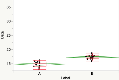

When I do the fir again and set the axis range to the same range. I copied the axis settings and pasted them to the new graph to ensure the same range is covered.  The points are not visible.  Previous versions would show them.  Is there something changed in JMP 16?

How do you "do the fit again?"
The current behavior is consistent with the intention of the row states. The excluded rows are not entered into the analysis, and so they are not shown in the plot.
Please note that I am not justifying this behavior. I am only explaining it.
I do not have JMP earlier than version 15.2.1 but it also behaves this way.

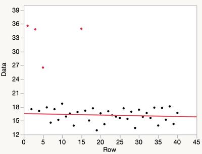

A second test,
Add a column with row number and plot as Bivariate.  After plotting you need to rescale the Y axis since the range in truncated, however the points are shown.  This is the behavior I expect by the terms hidden and excluded being separate states.
