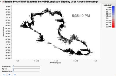

I did something like that where I wanted the g-force vector plotted for every location along a race track.
To get the lines, I added a customize script to the graph like this:
Pen Size( 1 );
For Each Row(
	Line(
		{:NGPSLongitude, :NGPSLatitude},
		{:NGPSLongitude + :gLong / 2000, :NGPSLatitude + :gLat / 2000}
Screen Shot 2022-12-12 at 11.27.16 AM.pngScreen Shot 2022-12-12 at 11.27.16 AM.png
I've attached the data file below. The first script (bubble plot 3) has the figure above.
