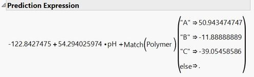

As for the slope of the lines, you can get that from the Parameter Estimates, but I think it is easier to see by going to the red triangle by Response Coal particles and select Estimates > Show prediction expression.
The common slope is 54.294. The estimates for each Polymer are the adjustment that needs to be made to the overall intercept.

Thank you.  The model you suggest is the one in the example and I saw the parameter estimates at the bottom of the example but it didn't make sense to me because I'm used to an output where the third parameter (polymer in the example) labels the dataset but is not used as offset.  So, I think what you are saying is, by adding the estimate for each polymer to the intercept estimate, I will get the explicit intercepts I am used to seeing. Thus polymer A has an intercept of -122.84 + 50.94 = -71.90 and polymer C has an intercept of -122.84 + 0 = -122.84.
Luckily I can quickly check this with my own data and compare the result to that from Matlab.  It will be so much more convenient to do it all in one tool!  A sentence or two explaining this in the help example might benefit a lot of users.  Thanks again.
