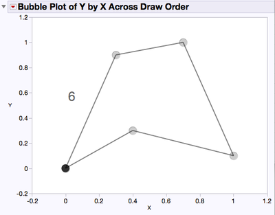

I used the Bubble Plot platform...
//Create a table with the drawing points, repeat that origin (start and finish)
drawDT = New Table( "Draw Plot",
  Add Rows( 6 ),
//Set the values for the coordinates to the table
  New Column( "X", Numeric, "Continuous", Format( "Best", 12 ), Set Values( [0, 0.3, 0.7, 1, 0.4, 0] ) ),
  New Column( "Y", Numeric, "Continuous", Format( "Best", 12 ), Set Values( [0, 0.9, 1, 0.1, 0.3, 0] ) ),
  New Column( "Draw Order", Numeric, "Continuous", Format( "Best", 12 ), Set Values( [1, 2, 3, 4, 5, 6] ) )
//Create a new window with bubble plot
New Window( "Draw Plot",
//On close of the window, the data table is deleted
  <<on close( Close( drawDT ) ),
  Bubble Plot( X( :X ), Y( :Y ), Time( :Draw Order ), Time Index( 6 ), Trail Bubbles( "All" ), Trail Lines( "All" ), )

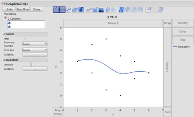

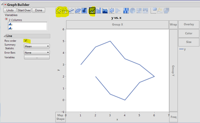

Craige_Hales
Re: Plot 2D Trace
start with a data table
Open graph builder and drag the variables to the axes
turn off the points and smoother and turn on the line and select row order
click done and save the script (red triangle) if you want to run it again without all the drag-and-drop
Graph Builder(
  Show Control Panel( 0 ),
  Variables( X( :x ), Y( :y ) ),
  Elements(
  Line( X, Y, Legend( 3 ), Row order( 1 ), Summary Statistic( "Mean" ) )
repeat the first point to close the loop if desired.
Craige
