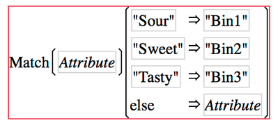

For your second question I would use the match function (below). You can write this yourself, or use the column recode utility to write it for you. To do the latter, select the original column, then go to Cols > Recode. Specify what new values you wish your variable to have, then select "Formula Column" instead of "In Place."  JMP will make you a new column using the match function.

You could use Cols > Recode in this same way for your first question, but if you have many levels using Word() will be faster than manually specifying the recoding.
