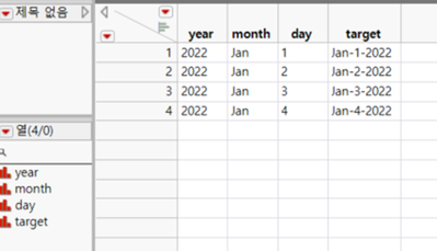

Please help me to make a calculated column of date type.
column1 = year     (ex, 2021, 2022)
column2 = month  (ex, Oct, Apr, )
column4 = day     (ex, 9, 10, 11)
(column 1,2,3 = string)
I want to make a new column in the form of a date by adding the calculation formula and merging the year, month,
What should I do?

I don't think I explained enough in this question, so I'll explain it again
I'd really appreciate it if you could help me again

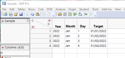

I want to make it in the target form in the fourth column of the JMP picture below
If I use the concat function, I can make shapes
But the problem is that it becomes a character type
I want to be a date type in the form of date/m/d/y
Only then can we match the payment amount by date in the other data table

Re: Please help me to make a calculated column of date type.
I understood what you were asking about.  The script and instructions I posted would work except for one small issue.  I assumed that your Year column was numeric.  You had clearly pointed out that the Day column was character, and the Month column had to be character.  But, you did not specify what the Year column was, so I assumed it was numeric.  The code below will recreate the sample data table you displayed and then will create the new column with the m/d/y format used for the Target column
