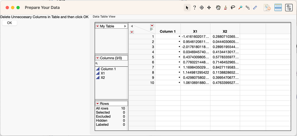

SamGardner
Level VII
Re: Pause Script Until After User Manually Works on Data Table
For this particular example, if you are wanting the user to perform manual operations on a table, you can create a data view/data box for that table that will show in the same window.  For example:
Names Default To Here( 1 );
dt = New Table( "My Table" );
dt << Add Rows( 10 );
dt << New Column( "X1", Set Values( J( 10, 1, Random Normal() ) ) );
dt << New Column( "X2", Set Values( J( 10, 1, Random Uniform() ) ) );
nw = New Window( "Prepare Your Data",
	hb = H List Box(
		V List Box(
			Text Box( "Delete Unneccesary Columns in Table and then click OK" ),
			Button Box( "OK", nw << close window )
		Panel Box( "Data Table View",
			Border Box( Sides( 15 ), dt << new data box(), <<border( 1 ) )
Wait( 0 );
nw << bring window to front;
