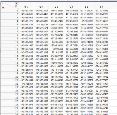

I have data from two separate runs.
data include: X,Y,Z
I want to comapre results based on X,Y coordinates (Z is the results)
the problem: for each run i get different coordinates. well, not completely different but not identical. within a range of +- 10.
how can i sort the data and compare the results (it has to be X and Y, not one of them only).
see table for example, (I've arranged the data in that order just so it will be easy to see)

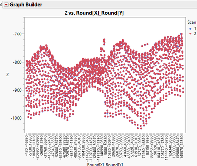

Re: how to sort and compare columns when data is not identical
Another way might be to round each of your X and Y values to the nearest 10 units, then concatenate them. I did this in 3 new formula columns in the attached data table, but it could easily be done in just one column. This would reduce the 2 dimensions to just one, after which this new variable could be the basis for whichever comparisons you're planning.
