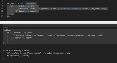

You can already get your issues with this type of script but it is much easier to test with something like this.
With script like this I would most likely resort to using Eval(EvalExpr()) because it allows me to do something like below (I can see the expression which will be evaluated if I just run EvalExpr() part)

I did find a solution by wrapping the variability chart function call with Eval(EvalExpr()) and then wrapping the column name inside of the transformation in Expr(Name Expr(AsColumn())).
