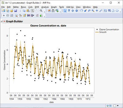

  Ideally I'd like to get an output where the graph builder date x-axis is automatically scaled to the most recent date, like this:

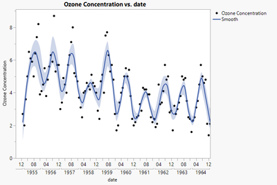

  Instead, I get a graph where it only updates to the value of when I saved the last version of that graph builder script to the data table. So, the output looks like this:
  This doesn't happen when you just graph the data points and don't modify the increment of the axis. The default increment on the axis for this data set (the first half) is 2 years. After you add the second half of the data, and rerun the script in the data table, it resets the default to 5 years and graphs all the data.
  However, if you change the default increment to 1 Month, for example, and save the script to the data table (first half), then add the new data and re-run the script, it keeps the axis settings the same as the original script -- it doesn't update to include the new data. The big difference in the script is the SendToReport command:

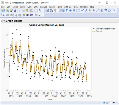

Re: How to have a preset graph for graph builder update axis upon re-running?
Hi @jthi ,
  Thanks, that did it! I do prefer to use the Expr(Col Min( )) and Expr(Col Max( )) in the Min() and Max() arguments for the graph builder. And, nicely enough, JMP will do the padding for you on either end of the graph, which must be somehow scaled by how large of a time scale your graph is, as it seems with this data set, it pads 366 days.
Thanks for the quick response!,
