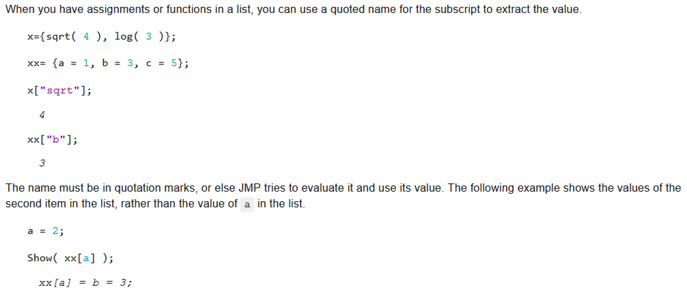

Works perfect.  Thank you!  Is that type of data structure documented?  I did not find it.
jthi
Re: Parsing << Get Estimates list elements
Lists do have quite a bit of documentation in Scripting Guide Scripting Guide > Data Structures > Lists in JSL Scripts . I think that behavior is also documented somewhere BUT it might not be under the lists section... I might have just gotten it by pure luck and trying out all sorts of things or I might have read about it (I will try to find it from documentation and will edit if I find it). @EvanMcCorkle
Edit: Found it mentioned at least here (I didn't find it from here first time I got it for sure, but it is mentioned) Scripting Guide > Data Structures > Lists in JSL Scripts > Subscripts in Lists
-Jarmo
