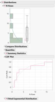

If you're looking at the example script and screenshot,
do you want the fit parameters of the distribution, like for the exponential fit below?
This would be no problem, you could JMP let calculate, in that case you save the formula and further process if needed ...

So all of those density functions you generated there provide parameters for them.  So does the Pareto distribution, which is a special case of the exponential distribution.  I was just trying to think through how to generate the alpha parameter for the pareto distribution using the Pareto platform in the same way the distribution platform will do that for the other distributions (like the fitted exponential distribution on the bottom of your report).
That said, I think your script showed me how I can set up the data so that I can model it with an exponential directly (which is perfect).  What had messed me up was that my data was in the un-summarized form so I couldn't get that distribution to work correctly.
