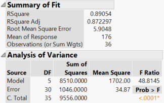

Second of all, JMP matches the output as far as it goes. The Regression Plot in Fit Least Squares is the same as the plot shown at the end of the PDF under Graphics. The Means and Standard Deviations report in Oneway platform (Y: Response, X: Level, and By: Type) is the same as the summary tables under Observations. The Results section can also be reproduced but it is not clear how they modeled it. It seems that they performed more partitions of the sum of squares than is usual and I cannot reproduce that level. In particular, I cannot achieve the R square values because they included additional factors. I think that it is the Row and Column effect from the Latin Square design. Also, there is no need to perform an ANOVA and a Regression analysis. That distinction is artificial.
Here is what I get from the ANOVA:
Separately, I get the sum of squares for the individual terms:

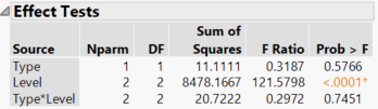

Your the change in your response appears to be linear so you can use Fit Model for this purpose. (If you had a logistic curve and model, you could use Fit Curve, which has parallelism and equivalence tests built in.) The 'trick' is to use additional terms in the model to test if the slopes are common or unique. This means an interaction effect. So select Analyze > Fit Model. Select your response column and click Y. Select your log concentration column and the sample type column, click Macros and select Full Factorial. Now click Run.
Examine the Effect Tests report. If the interaction term is significant, then the curves are not parallel. If the term is not significant, then the curves are parallel and you can remove this term. Finally, if the term for the sample type is significant, then you have a unique intercept for each type otherwise you can also eliminate this term and use a common intercept. At this point you would have a model with only the intercept and log concentration.
Capture.PNGI don't have time to add the Row and Column values to the example data table. If they were added, then I could show you how to include them in the analysis if you need the help.
