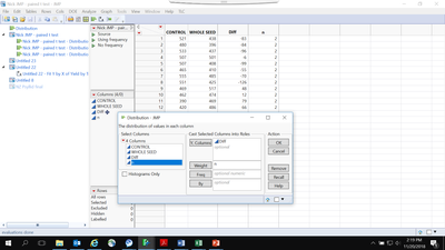

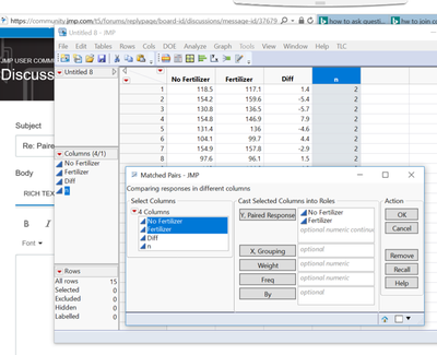

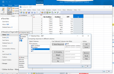

Paired t test.pngHi I want to compare between two treatments: 1) No fertilizer and 2) Fertilizer. I wanted to know whether there is an increase in yield due to the fertilizer application. Two parallel blocks were selected, in the first block no fertilizer was applied whereas in the second block the fertilizer was applied. Fifteen samples were harvested from each block. I would like to use the paired t test and there are different methods in JMP. I thought to use the distribution and then test means. My question is that is adding the column “n” for “frequency” is correct? Please explain why or why not. If I use n as frequency in the data analysis the results changes as the degree of freedom increase from 14 to 29. Paired t test.png
12 REPLIES 12
cwillden
Super User (Alumni)
Re: Paired t test
No, do not add a frequency column.  Each pair is 1 data point in a paired t-test.  A paired t-test is mathematically equivalent to a 1-sample t-test on the paired differences.

Thanks so much for your quick reply. I understand that the paired t test can be performed by using the following four methods: I am wondering whether all four methods are equally good. If not which one is the best and why? I got identical results.

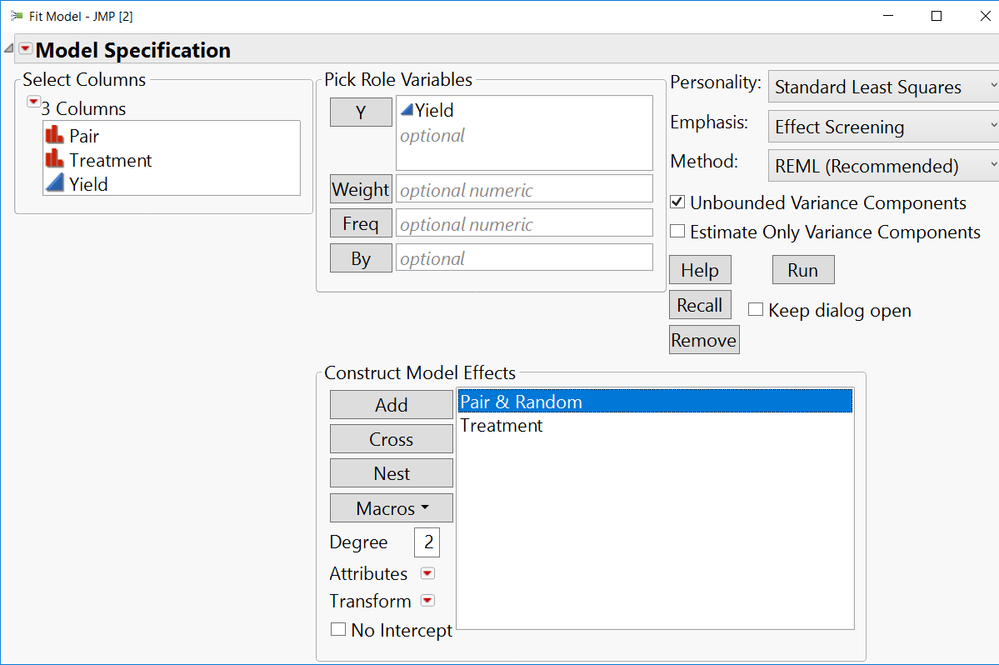

Here's an example using Gosset's Corn data from the JMP's Sample Data Library.  I added a pair ID column and then stacked the 2 yield columns (Kiln and Regular) to get to a long data format.  Make sure the pair ID column has a nominal modeling type.
From Fit Model:
1. Add the Yield column as the Y, Response variable.
2. Add the Treatment and Pair columns into the Construct Model Effects box.
3. Select (highlight) 'Pair' in the Construct Model Effects box and make it random by clicking the Attributes red-arrow > Random.

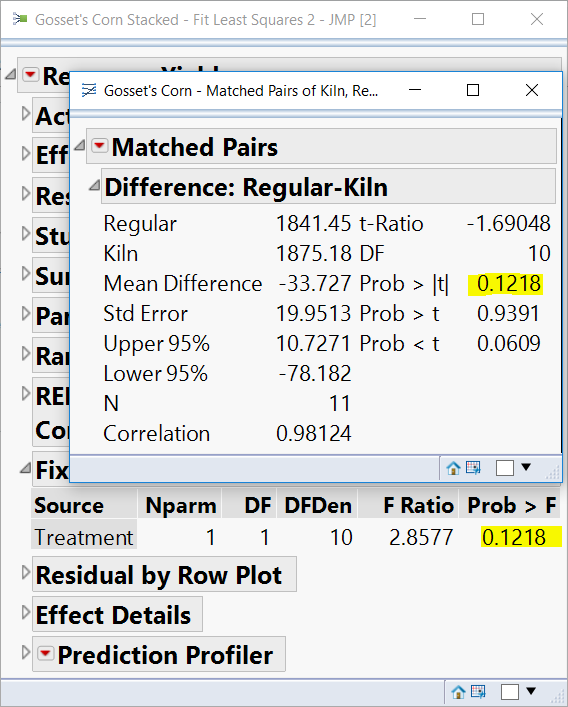

You'll see the p-value for Yield has the same p-value as the Matched Pairs platform for the same data in the original wider format.MatchedPairsPvals.PNG

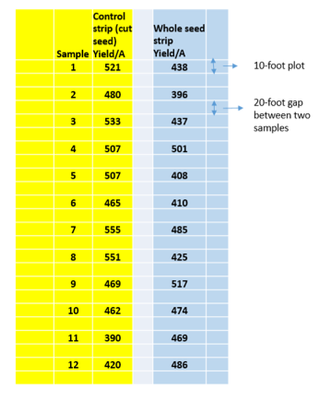

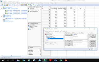

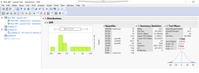

We wanted to compare between two seed types in potatoes (planting Cut seed vs planting whole seed). Cut seed is used as control which is a common practice. This trial was conducted at the grower’s field. The field was divided into two strips blocks, the first block (in yellow) was planted with control (cut seed) and the second block (light blue) was planted with the whole seed. These strip blocks are really long 400-foot. In total, twenty four samples (12 from each strip block) were harvested.  Each sample was harvested from a 10-foot long row plot and converted the yield in CWT per acre. The field variation was huge. The trial was conducted at grower’s field. So, we could not randomize the treatments. I have analyzed the data using the paired t with distribution and test mean, see below:
My question:
I understand that we should use the paired t test.
One of the great statistician suggested that we should create an extra column frequency and use it for the analysis. I have analyzed the data with and without using the frequency.
I wanted to know which method is incorrect and why?
Which method is correct?
I would appreciate your time.
Best regards

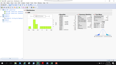

  • I have created difference and frequency columns and both
See the results below: They are significant P >0.0232
  • I have created difference and frequency column but this time I did not use the frequency column
Results see below: Non significant P >0.1208

You description of blocks is yellow and blue, so the blocking (pairs) does not make sense,
If the cut and whole seed plantings occurred next to each other, but the 12 strips are separated over a variable fied, the blocking (pairs) make sense. Is the field homogeneous within a pair? That assumption is important.
Yu do not need any more than the two response columns, CONTROL and WHOLE SEED. Use the Matched Pairs platform in the Analyze menu. Enter both of the data columns in the Y role in the order above. Do not enter any other data columns in this analysis.
It seems that you expect a higher yield for the whole seed treatment (alternative hypothesis), so an upper-tailed paired t-test is called for.
