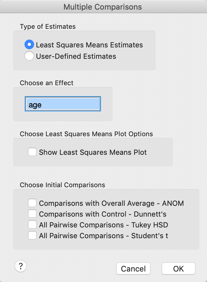

First, you have the t ratio to test the value of the interaction term to the model. The interaction term represents a different effect of the predictor at different categories. (You know this because you selected ANCOVA.)
Second, the Fit Least Squares offers a selection of multiple comparison options. Click the red triangle at the top and select Estimates > Multiple Comparisons.
Screen Shot 2019-07-16 at 7.32.29 AM.pngScreen Shot 2019-07-16 at 7.32.29 AM.png
