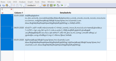

tnqnt
Level II
Re: Output JMP table to formatted journal or picture with wrapped cells
This is the type of table.  By long data, I just mean a lot of characters :)
If I dump it to a journal, it doesn't keep the column or row specifications from the table and it does not wrap the text.
I need the output to look like this, but in photo or some other format I can transport to non-jmp users.
thanks so much!

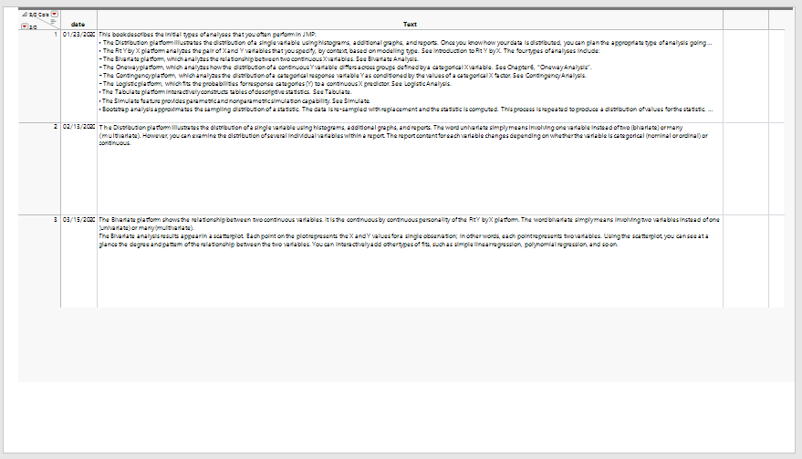

txnelson
If you run the following after creating the Example data table I sent
 dt<< set window size(1500,800);
dt:text << set Display Width(1200);
nw=new window("test",<<journal);
dt << close side panels(1);
nw<<append(window("Example")<<get picture);
nw << save presentation("$TEMP/text2.pptx");
open("$TEMP/text2.pptx");
You will get a PowerPoint slide that looks like this
This is pretty close to the best you can get using this approach.  You could take the time to create your own Display Window, using alternative display objects that should get you exactly what you want.
Jim
