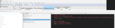

// no need to discuss this, because this obviously missing the 'eval(eval expr(expr()))' wrapping (see screenshot below) dt << New Column( "QcParameter [% rel.]_1", numeric, formula( curBatch = :BatchId; curCondition = :StorageCondition; theRows = dt << get rows where( :BatchId == curBatch & :StorageCondition == curCondition & :Time == 0 ); d0Row = theRows[1]; d0Time = :QcParameter[d0Row]; (100 * :QcParameter / d0Time); ) ); // adding formula column via approach nr. 2
// this will fill the formula column as desired when copying and running the table script with the added formula columns

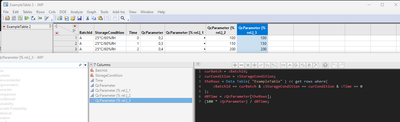

// but it will also throw an error message when new rows are added to the table then (see screenshot below) Eval( Eval Expr( dt << New Column( "QcParameter [% rel.]_2", numeric, formula( curBatch = :BatchId; curCondition = :StorageCondition; theRows = Expr( dt ) << get rows where( :BatchId == curBatch & :StorageCondition == curCondition & :Time == 0 ); d0Row = theRows[1]; // removed from approach nr. 3 d0Time = :QcParameter[d0Row]; (100 * :QcParameter / d0Time); ) ) ) ); // adding formula column via approach nr. 3 // this will fill the formula column as desired when copying and running the table script with the added formula columns
// and it will NOT throw an error message when new rows are added to the table then (see screenshot below) Eval( Eval Expr( dt << New Column( "QcParameter [% rel.]_3", numeric, formula( curBatch = :BatchId; curCondition = :StorageCondition; theRows = Expr( dt ) << get rows where( :BatchId == curBatch & :StorageCondition == curCondition & :Time == 0 ); d0Time = :QcParameter[theRows]; (100 * :QcParameter) / d0Time; ) ) ) );
Screenshot of error message for formula column "QcParameter [%r rel.]_1]" when rerunning table script with additional formula columns:
Screenshot of error message for formula column "QcParameter [%r rel.]_2]" when rerunning table script with additional formula columns:
Screenshot of error message for formula column "QcParameter [%r rel.]_3]" when rerunning table script with additional formula columns:
The reason why I am asking this lengthy question is that I assume there must be some reason why variable "d0Row" is used in approach nr. 2, no? For approach nr. 3 I have simply deleted this variable (see screenshot below) and the formula behaves "much more nicely" as a result, i.e., there is no error message when new rows are added ad-hoc by point & click to the data table.
My question is therefore, if I am doing something wrong by deleting the "d0Row" variable. In real life I am working with larger data tables and won't be able to check each row individually for its accuracy.

Re: Optimizing a column formula for standardizing time resolved data to 100% rel. at t=0
I am not completely sure I am following your issue, but what I am seeing is that your reference to dt is when you copy formula 1, the reference to dt is missing.  In example 2 and 3, you end up with the data table reference pointing to data table "ExampleTable", and your data table name, as shown, is "Example Table 2".  Again, if I am understanding your issue,I think you can solve the issue by using "Current Daa Table()".
theRows = Current Data Table() << get rows where(

Thanks! I'll try and summarize again:
  1. When adding the three formula columns to the example table previously without formula columns, then copying and executing the resulting table script of the table now containing the three formula columns, only examples 2 and 3 will populate the corresponding formula columns with the expected, relative values. The first formula column stays empty.
  2. Moreover, when adding new rows to the final table created under 1. (i.e. from the table script containing now all 3 formula columns), only the third example will not throw an error message when adding new, empty rows.
Because of this observation I removed the "d0Row" variable as part of example 3. Following this, no error message appears when adding new rows to the table and it reproduces the relative data as expected. The question therefore is if "d0Row" is at all required. I created example 3 specifically to test this hypothesis. (Removing "d0Row" makes the formula shorter, but my concern is that this variable is essential or that I am overlooking something. Am I?
I am not sure this is related to using or not using "current data table()" in the formula. I've used "current data table()" as a workaround for a long time now. This will still result in error messages when adding new rows to a table, but I still want to be able to add new rows to a table without having to constantly confirm error messages for every relative column in a table when a new row is added. There are dozens of relative columns in them and it costs time to repeat this operation. It is of course possible to suppress evaluation, but this also costs time. Apologies if this example is not clear, but I'm willing to explain further.)
