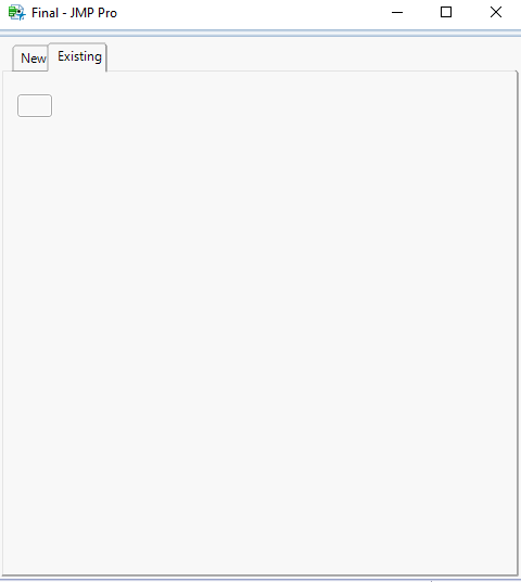

 Output from Jmp 12.2.0 included below. New tab is populated but Existing tab does not have the plot.
I am limited to usage of Jmp 12.2.0 so would like to figure out a way to get this working. Appreciate help and pointers.
Thanks!
ih

uProf
Level III
Re: Open closed file and append
Hello Ih-
Last line of code is not working as expected in Jmp 12.
There is no error message in the log either when last line is executed.
