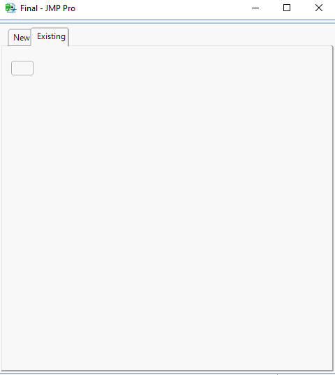

I took this a step further to append each jrn file as a tab in a consolidated journal file.
Shown below is modified code that works in Jmp 14.3.0 but not in Jmp 12.2.0.

 Output from Jmp 12.2.0 included below. New tab is populated but Existing tab does not have the plot.
I am limited to usage of Jmp 12.2.0 so would like to figure out a way to get this working. Appreciate help and pointers.

Re: Open closed file and append
Hello @uProf,
If you step through your code, running one line at a time, in 12.2, what line does not do what you expect it to?  For example does the the existing journal open and contain everything you expect it to? Doing that bit of troubleshooting will lead you to a more specific question and get you to a solution faster.
Hello Ih-
Last line of code is not working as expected in Jmp 12.
There is no error message in the log either when last line is executed.
