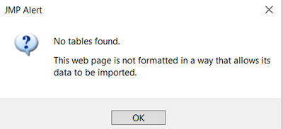

How do I write a script to open a table that is on an Atlassian Page ? I tried below
dt = open("https://impinj.atlassian.net/wiki/spaces/UNI/pages/79855941/12+AOI+Disposition-2022", html table(1));
I am using JMP17.

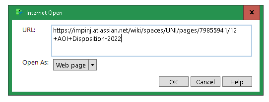

To import data from the internet or a remote computer as a data table in JMP, you can:
  1. Select File > Internet Open and select the file
  2. Click the Import as Data Table icon in the upper right corner of the JMP browser
  3. A window appears that lists the tables found in the web page
  4. Select the table or tables that you want to import
  5. Click OK

Hello Thierry,
I could not open the table using your method. There is a table on the webpage but it says it could not find it.

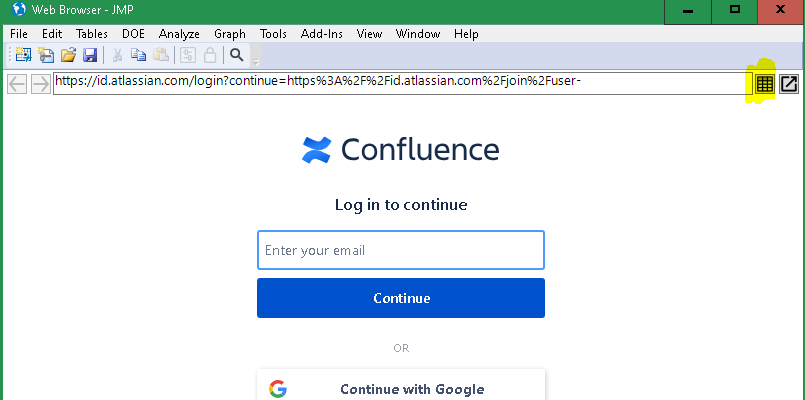

JMP could not find <table> elements in the html it received. Maybe one of these:
  1. The apparent table is formatted without using <table> elements
  2. The site requires a login and JMP is seeing the login page
  3. Wrong URL and JMP is seeing an error or other page
Open the table in a browser and use the right-click->view source option to see if there are <table>, <tr>, and <td> elements in the html. <tr>...</tr> for each row and <td>...</td> for each data value.
Try
write(loadtextfile("https://..."))
and check the log. Study the html to see if it looks like your table or an error message or a login prompt.
I'm pretty sure JMP is seeing the login page, not the page with the table.
If this is a one time download, @Thierry_S  has the best answer:
Pick the web page option.Pick the web page option.Login, go to the page you need, then the high lighted button.Login, go to the page you need, then the high lighted button.

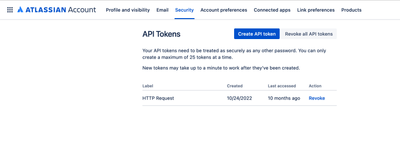

Much of the data in Atlassian (Confluence and Jira) is non-tabular and has customizable fields. In short, it's JSON, at least from the REST endpoint perspective.
The easiest way to get started is by creating a Personal Access Token (PAT) in your Atlassian. I did a while back (as you can see from the screen shot) but I still had to hunt around for it
https://confluence.atlassian.com/enterprise/using-personal-access-tokens-1026032365.html
