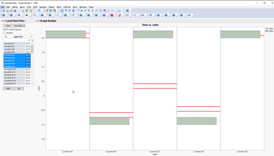

Hello,
I am trying to add LL and UL lines to each label group of the GB plots. Based on the local data filter selection, I want to create a function that will add H lines from the UL and LL columns to the graph builder corresponding to the respective labels. Is this something that could be done?

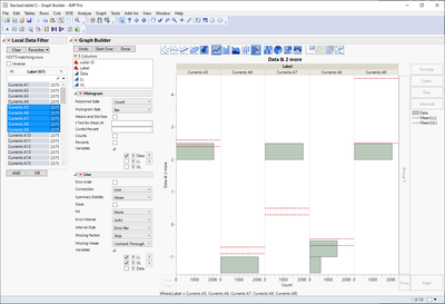

jthi
Re: Add H lines to the Graph Builder from the Column values
If you use X Group it is fairly simple
You might also be able to use Float bar chart and modify it's width proportion from customize menu
It can also be done with graphic scripts, but I would try without first
-Jarmo
