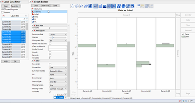

For instance, if I make a plot with a X group, and I want to put different reference lines for each group/panel only. Is that possible?

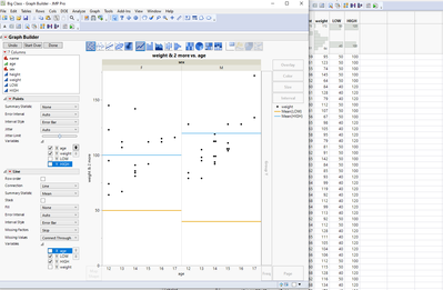

No specific scripts needed in my example, just have limit columns and use two different plots in graph builder and disable unnecessary variables

Quick Question - Is it possible to add a reference line (LL and UL) in each group of the plots from the Columns UL and LL in the data table?
