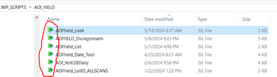

This morning I installed JMP18 but I changed my mind and uninstall JMP18. I still have JMP17.  After that, the JSL file scripts looked like this in my File Explorer. When I double clicked a script, it will execute right away.

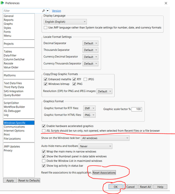

To resolve this, in JMP, go the File --> Preferences :
* Make sure to uncheck "JSL Script should be run....".
* Press the Reset Association button and click OK
* Close all your File Explorer windows and open it back up.
* Right click on a script and choose what ever version
* The problem is resolved and now I can double click at a script and open it in JMP without executing it.
