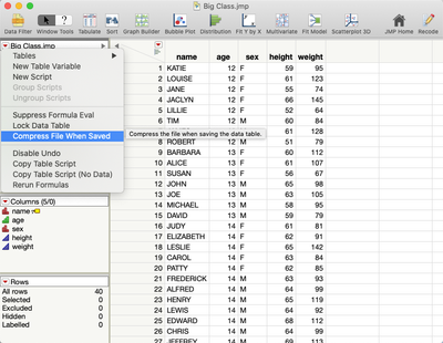

If you're using gzip to compress the files outside of JMP you may be taking a step that's not necessary. You can save tables in compressed form using an option in the data table.
This will use GZ compression on each column to make the stored file smaller.

Jeff_Perkinson
Re: Open *.JMP.GZ File (gzip)
-Jeff
nmossery
Level II
WOW , I was not aware of this option .
I will try to add it to my default save file option in my script .
Thanks !
