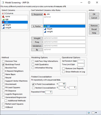

The Model Screening platform actually makes this pretty simple, just set K in the Folded Crossvalidation section equal to the number of active rows.
Find details for each fold in the Details section of the report, and if you want to know which row goes with which fold you can open the Training section, select a row corresponding to that fold, and press 'Save Script Selected' under the table.  A new column will be added to the table which indicates the validation rows.

From my side, using "Model screening" and the setup you proposed does work for K-folds crossvalidation, but not always for Leave-One-Out method (depend on dataset).
If I specify K = number of observations, an error message appears "The validation sets inside each of the folds are too small to support some methods", even if only Bootstrap Forests is checked in the "Method" panel. So I also thought about using the "Model screening platform" but it may not be possible, depending on the dataset (on "Boston housingprices" dataset with this method I have no summary of the folds and missing values in each folds details). It does work for the "Big Class" dataset.

Re: One hold out cross validation
Hi @Victor_G, I don't believe that is an error, just a warning message.  I do not think the unavailable methods will not affect this analysis.
