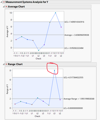

Re: How to repeat points across extremities in a custom DoE to better understand variance?
I agree there are very good answers here, but I'll add perhaps one more with a specific approach.
>>i.e. how can I assess variability in relation to the factors in the design space as opposed to just the response?
You can use the EMP platform to see if specific regions of your design space have more variation than others. Credit goes to Bill Kappele for inventing this tactic, which he calls a "Sanity Check." In the example below, one of the areas/trials in the design space has more variation than the others. The trick involves creating a new "check" column, which is an indicator of all your factor levels. It also assumes that you have repeated runs in enough places to be able to estimate variance. I've attached a sample data table for which the EMP script on the table outputs the example below.

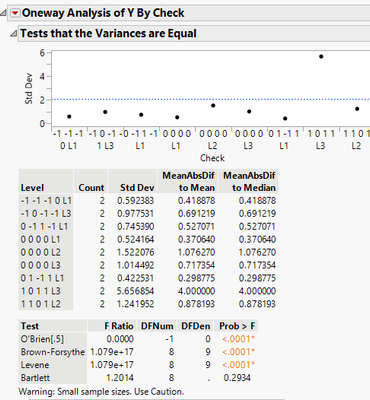

If you want a statistical rather than visual test, the Unequal Variances test in the Fit Y by X platform can give this (also saved to data table as Fit Y by X).
aaidaa
Level II
Hi Jed,
Thank you for this, this is a super useful tool!
I'm assuming the Y here is simply the response and not the variance of response and therefore it would be most useful to look at the range of Y against the check. Given the fact the assumption here is having conducted enough repeats of experimental runs, do you know what the minimum number of repeats required are? I could probably repeat 7-10 runs but I would have to somehow augment the design to include those repeats, since I've only repeated centre points in my original design. Do you have any additional suggestions?
Many thanks for your you help!
