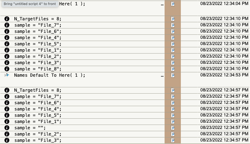

Hi,
I'm puzzled by the detection of deleted files by JSL (JMP 16.0.0 on a Mac Big Sur 11.6.8).  I created a folder containing 8 files and ran the following script:
Names Default To Here( 1 );
TargetDir = Pick Directory();
TargetFiles = Files In Directory( TargetDir );
N_TargetFiles = N items(TargetFiles);
show(N_TargetFiles);
For( i = 1, i <= N Items( TargetFiles ), i++,
	sample = Left( TargetFiles[i], Contains( TargetFiles[i], "." ) - 1 );
	Show( sample );
The Log indicates 8 files were detected (see attached, first run).  Then I deleted one file in the folder and ran the script again.  The Log still indicates 8 files are present and it includes a "" to indicate that one was deleted (see attached, second run).  If I start over with 8 files and delete 6, 3 are detected, one of which is "", so maybe "" indicates a temporary file indicating files were deleted.
Is this a known behavior of JSL/JMP on a Mac or with Big Sur?  How can I avoid including the "" item in the count and on the list?
Thanks for your input.

Re: On Mac Big Sur JSL seems to detect a file indicating deletion of one or more files
Thanks very much for your help.  I discovered the mystery file is a hidden .DS_Store file that occupies a Mac directory when one or more files is deleted, which I confirmed in my directories using Terminal ls -a to reveal hidden files. I renamed the file list in my previous script, then modified your suggested syntax to filter away the .DS_Store file (see blue script below). The script counts files properly and avoids the mystery "" file.
The goal is to automate file processing on a selected folder containing target files. I was working through an alternative approach to select only files with the desired .txt extension, which might also exclude other "contaminating" files in a directory, but since your suggestion worked I'll likely continue with it.
I would call this a Mac bug rather than a JMP bug, but I suppose that's arguable.
 Thanks for tagging me, @Craige_Hales. I can confirm that this was a bug in JMP related to the invisible .DS_Store file that appears on Mac to store history information for a folder. I can also confirm it has been addressed in JMP 17, which will be released in a couple of months. Thanks for providing the nice workaround!
