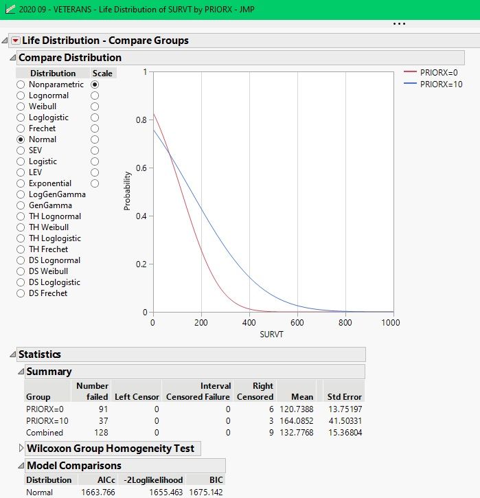

Hi Mark, thanks for weighing in.
I have performed the Life analysis as you've suggested and obtained curves.  However, I am not seeing any method in the Life Analysis that will create an adjusted graph which accounts for covariates.
In the image I have created the graph using SURVT as the survival time and I set up the censorship variable and compared the two Treatment Groups (PRIORX).  This creates the basic Kaplan survival curve and I can select different models on the left ... one of which is the loglogistic (which I think is the same thing as the Log-Log survival curve).
The question is ... how do I get this to adjust for covariates?  There are two covariates I want the graph to account for and I'm not seeing any way to put those two covariates into the analysis except if I use the Fit Proportional Hazards tool ... but that doesn't generate the survival plots.
