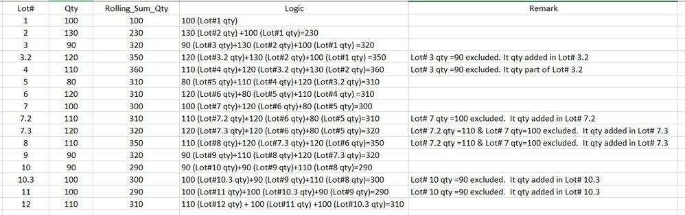

My data starts with two column, Lot# & Qty.
I need help to create script to calculate rolling sum (current row + previous 2 rows) of previous row values.
The logic is explained as below table.

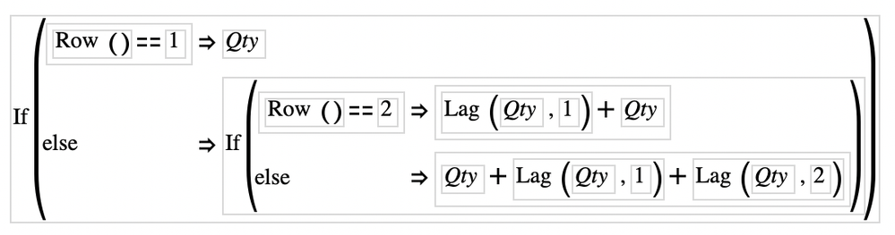

One way might be to use a formula like this:
Screen Shot 2020-09-22 at 3.04.46 PM.pngScreen Shot 2020-09-22 at 3.04.46 PM.png
If( Row() == 1,
	:Qty,
	If( Row() == 2,
		Lag( :Qty, 1 ) + :Qty,
		:Qty + Lag( :Qty, 1 ) + Lag( :Qty, 2 )
For the first row there is nothing to sum, so it just uses row 1
For the second row there are only two values, the current and previous, so its row+lag(1)
All rows after the second it takes the sum of the current row plus the previous two rows :lag(1) and lag(2)

My dataset is not able to do rolling sum directly using the formula because some lot data is not take into count.
Example,
Lot# 3 and Lot# 3.2, only Lot# 3.2 qty is count in rolling sum because it is final lot qty.
Additional qty added in Lot#3. It become Lot#3.2.
It is the same for Lot# 7, 7,2, 7,3 and Lot# 10, 10.3.
Lot# 7.3 qty and 10.3 is count in rolling sum because it is final lot qty.
Need guidance from the community.

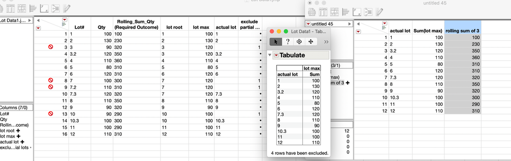

Is this right. (the right most column in the picture)?
Screen Shot 2020-09-24 at 2.32.20 PM.pngScreen Shot 2020-09-24 at 2.32.20 PM.png
JMP Systems Engineer, Health and Life Sciences (Pharma)
bzanos
Level III
Re: Rolling Sum of Previous Row Values with Condition
Yes, that is right.
But I want to maintain the original data table without excluding some rows to get this result.
Can this be done?
