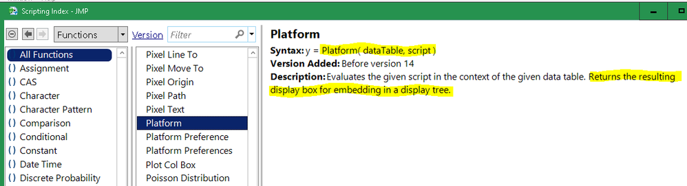

You want to use the platform(...) function.
Scripting Index is in the Help menuScripting Index is in the Help menu
When a platform launches, it will attach itself to a new window if it is being created within the new window construction, or a displaybox if is is being created within a displaybox construction. Otherwise it creates a new window. The platform() function returns the root displaybox without attaching it to anything. In the past I've also recommended using a borderbox wrapper around the dt<<processScreening, but I think platform() is better.
The scripting index example would make more sense like this:
