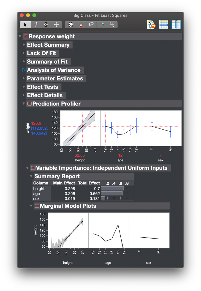

The profiles are based on the whole model, including any non-linear terms. The profile for one variable simply fixes the other variables at their current value. So the sampling of variable values is used with the entire model:
This model includes terms for all three interaction effects.

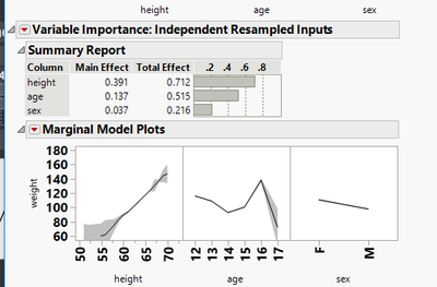

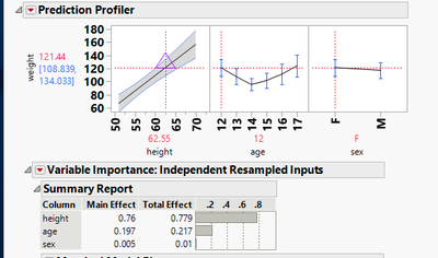

I replicated the same model and provided screenshot of 2 version, one which has only the main effects and the second which has all 3 interactions and main terms.The main effect of height in the no-interactions model is 0.76, whereas in the factorial to degree interaction model, it is 0.391.How to read more into these two numbers? Basically I am trying to assess the rel importance of height alone and height*weight and so on.
1)This difference ~0.36 is due to the interaction of height with other terms as well as the other terms
2) 0.76 includes main effect of height and interactions?
3) Are interaction terms implicitly treated as another independent variable irrespective of whether the model explicitly includes main and interaction effects?
factorial to degree main and interactions
Only main effects and no interaction terms

The Total Effect is defined as an index that is directly proportional to the variability in the predicted response for some given variation in the factor or predictor. This index reflects the relative contribution of that factor both alone and in combination with other factors.
So, if I select the first-order model, the Total Effect of height, age, and sex is 0.779, 0.217, and 0.01, respectively. On the other hand, if I select the model with first-order terms and cross terms, the Total Effect of height, age, and sex is 0.712, 0.515, and 0.216, respectively. I would not expect the importance of any one variable to remain the same across different models. The change in an index across models is not important.
The profilers are provided for the exploitation stage of modeling, which follows the selection stage. We might monitor the change in AICc across different models during the selection stage. AICc would not be useful in a prior or subsequent stage. Similarly, the total effect index is useful during exploitation of the selected model, not in a prior stage.
You should not use this feature to select one model over other candidate models. You should use this feature to explore and understand the selected model. So looking at changes in this index across different models using the same factors is not meaningful.
Please see Help > JMP Documentation Library > Profilers > Chapter 3: Profiler. There is an entire section in this chapter devoted to explaining the Assess Variable Importance feature. The end of this chapter includes a section with the statistical details, including those for the calculation of the various importance indices.
